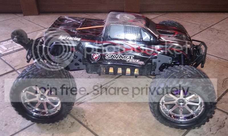

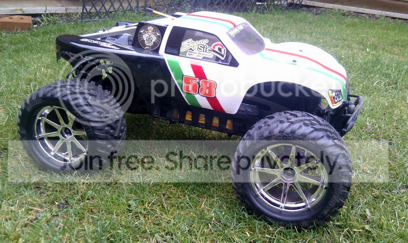

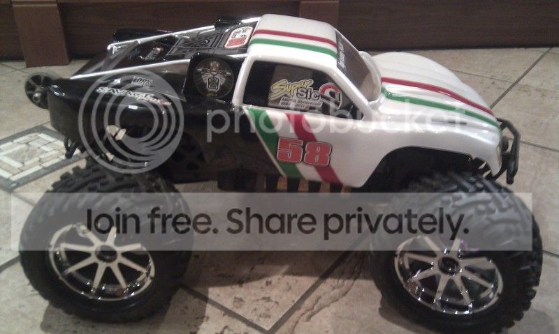

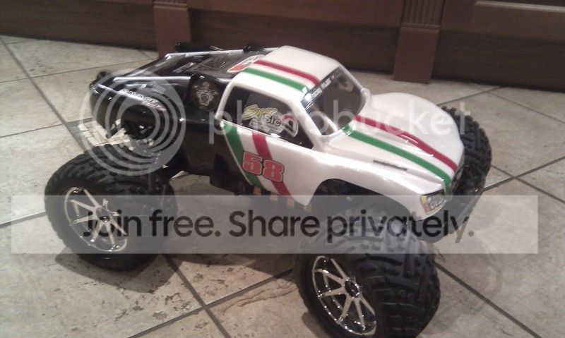

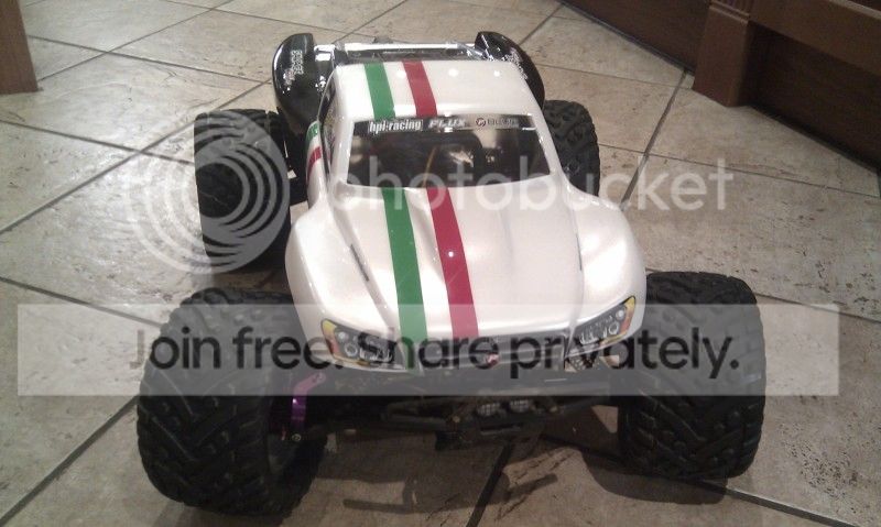

Hi everyone this is my first post on forum. have returned to rc cars after 30yrs absence

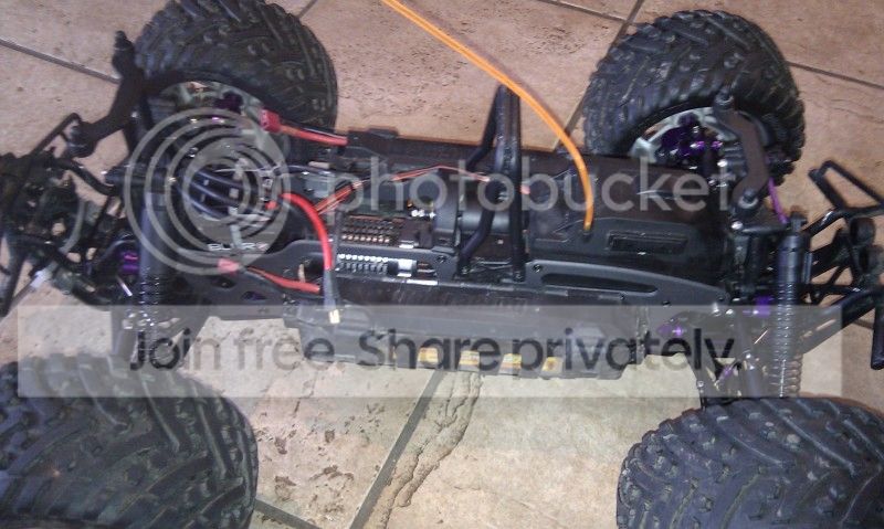

Have had savage flux hp for 8 weeks now and have spent way to much wonga on her. she's turned in to a xl length and width monster with sway bars and hpi handeling kit. home made wheelie bar as hpi one didn't last long.
This is my first attempt at a paint job, its a bit rough in places but i think a good tribute to Marco. hope you like
Did you have to do much mod to the shell to fit?? Good paint job!

before

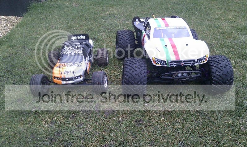

after

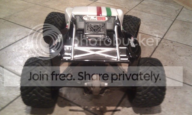

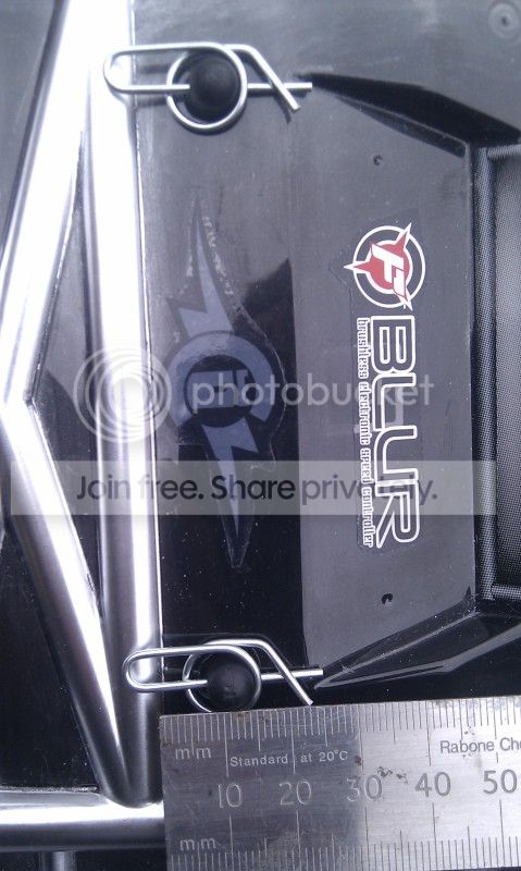

body fits real easy, rear mount holes drilled 10mm from front of roll bar 90mm apart
and front mount holes are drilled 1mm directly behind the inner dimples on body.

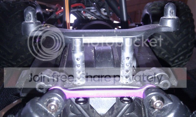

front body mount raised to show four and half holes

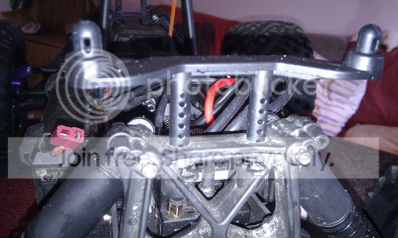

rear mounting also four and half holes but also taken out and put back in the other way round

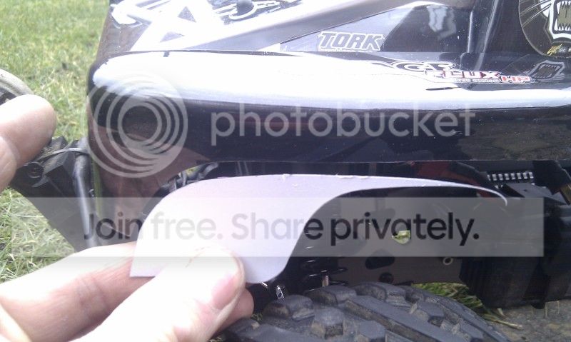

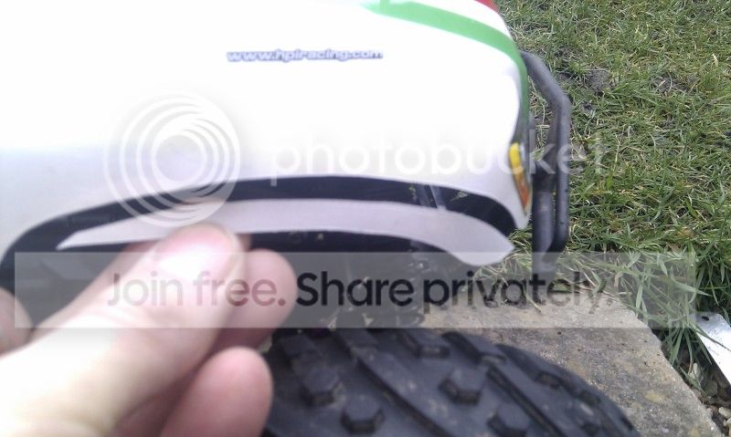

front arch cut
rear arch cut
tyres just touch body when suspension fully compressed.
another hole on show from and back on mounts should sort this.
also if you ain't running such "goliath" wheels it work better.

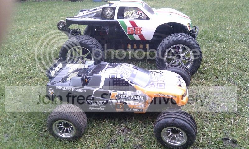

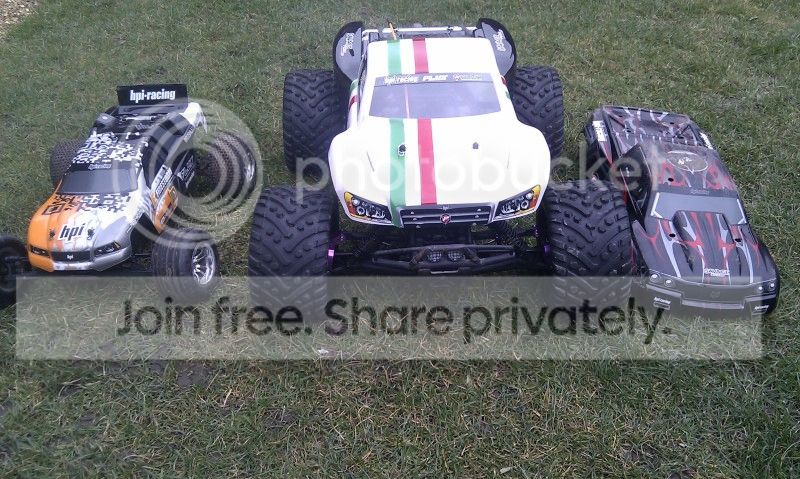

I didn't get this body for bashing its more for a shelf queen role when she's not in use. so i don't know how well she would last, original body is for bashin.

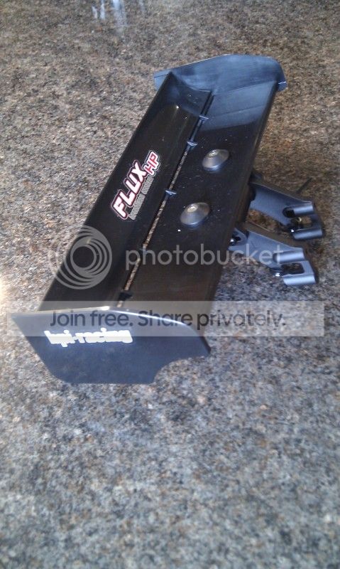

just gota work out how I'm gona fit this

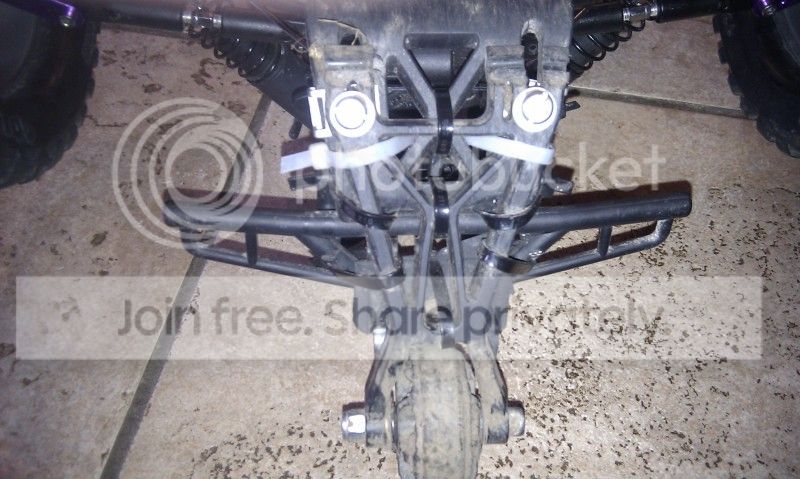

made this out of a bust wishbone when the hpi one broke.
this one takes the abuse

That's a nice looking savvy. I have the same rims (with phatline tires) on my nitro savage x. I just bought a flux hp and am looking for ideas on what to do with it.
