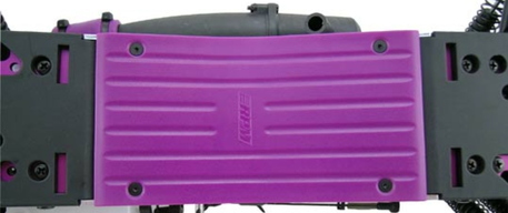

Skid plates aren't actually necessary as the car doesn't touch the ground when you apply all force on it. Sorry if I understood that wrong, maybe meant something like this:Screenshot_20230506_222430_Google.jpgyou can buy the ready version. I just bought a mousemat, drilled the holes and boom (more of a mud protection, not really to protect the car). Did this on both my savages.
