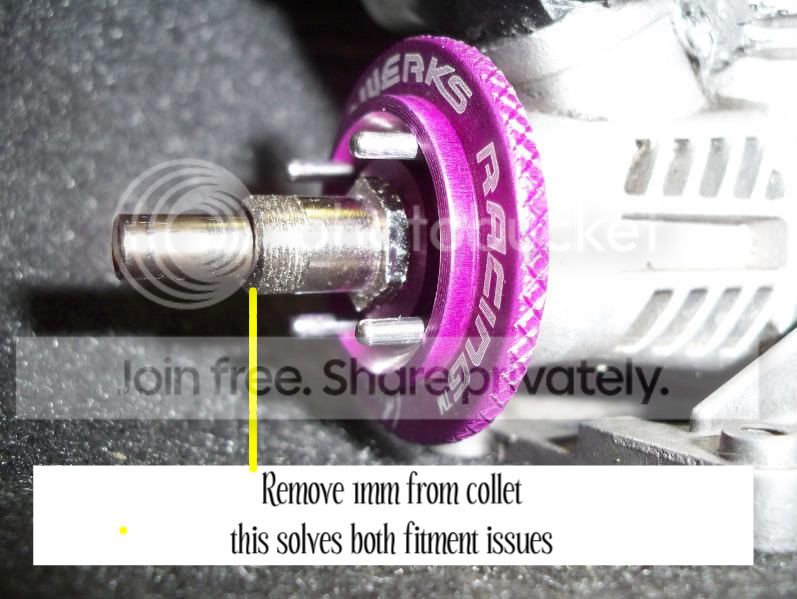

I had bad luck finding the rite cb for this clutch
I ordered what i thought was rite and it wasnt, 17 dollar mistake
also, bought a nova engine mount 15 bucks
after buying a bucnh of stuff that didnt work, I started over and
I modded the collet that came with the clutch to work.
The main problem was the shoes were sticking out the back of the cb 1mm
so I removed 1mm from the collet. The mfg. says you have 3mm of adjustment, basically I removed 1mm of the adjustablility.
If you don't like this mod ask mega for the part number of the cb that will work.

http://www.gshobby.com/index.php?main_page=product_info&products_id=11212 this is the collet I modded

I replaced the collet nut after modding it, the decrease in adjustability did come into play. I had too much of a stall before the shoes would engage, it made it hard to get around the track.
now after setting it to the recomended setting.
