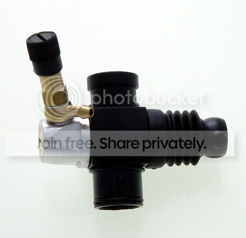

A mid range needle is kinda like the low speed needle .. looks kinda the same
it can be found on on the direct opposite side as the low speed needle.
Here is a pic of the surefire .32 carb
mid range is to the left and down by the HSN
Then You don't have one so don't worry about it. I myself have Two mills with the mid needle and have learned to leave it alone.
